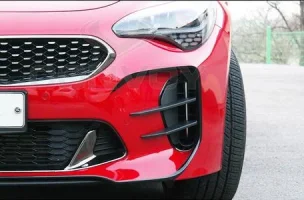

I just installed claw canards (non-LED) on the front of my Stinger.
About a day after installing them, I noticed I started getting false triggers on the front left collision sensor (I am not getting alarms on the center/right sensors).
Has anyone that has installed canards, had any issues with them triggering the sensors in the front bumper?
Or it must be a coincidence that I now may have a failing sensor on the left side... ?
Sucks, as this will engage the anti-collision braking, if it's enabled.
Anyone have one fail yet? Wonder if the dealer will give me problems asking them to troubleshoot it under warranty, with canards installed.
example pic attached...

yeah... and in the same time frame that it started, we had torrential rain downpours. I am wondering if something is stuck on the sensor (dirt, debris, etc) or if rain water got inside a sensitive/sealed sensor part.
Gonna take it to the dealer... I can't have the anti-collision system throwing false alarms.
Forgetting to turn it off just once, could crash me...
Not sure what algorithm is used for the front emergency braking, but I doubt that it uses the parking sensors, their range is too limited. I thought that it used the active radar unit mount behind the center of the grill.
I've had my (LED) canards for a year and only rarely get false parking sensor beeps (usually when they're wet). I have anti-collision braking enabled and have never had it activate randomly.
Thanks for the replies...
I've found that it's the Parking Assist that is alarming, and not the anti-collision. It's going to the dealer to have them troubleshoot this particular sensor. There are no alarms in Drive/Reverse when above 15mph, so no fears with the anti-collision braking engaging randomly...
For now, I've temporality disabled the Park Assist to stop all the false alarms.
