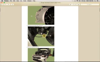

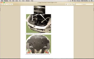

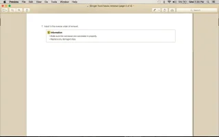

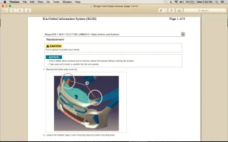

so i recently had to remove my bumper to install a front m&s lip i got Good - Philip Factory has done it again AAA+++ (Full Premium M&S Kit) i wanted to do it right instead of jacking the car up on jacks. anyways here some instructions on how to do it hope they help. btw it only takes about 15-30min to remove it depending on if u have the right tools. the second time knowing how to do it should be faster. good luck fellow stingers.

Where did you get this from and how can I get access to it?
It’s Kia Global Information System. It’s a paid access website intended for dealerships and repair shops. $19 will get you 72 hours of access.

This PDF was mirrored and downloadable online - Discussed in this forum thread
Not sure if it still works because I'm at work and the nannies are locking me out of the website.
Definitely worth the download - tons of useful info.
So there is an extra step. Have to disconnect the camera before taking the bumper off
No extra step. It’s all part of the same harness you disconnect as shown above.
