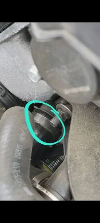

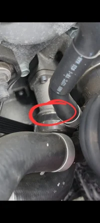

It's possible, but I couldn't see anything. I did notice a hose that seemed pushed back quite a bit, but the connection was still super tight. Boost spike? Idk. I'll add a photo when I get to the car.
