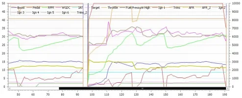

socalvn Stinger Enthusiast Joined Feb 9, 2022 Messages 888 Reaction score 410 Points 68 Feb 16, 2022 #1 Thanks guys appreciate your support here minimal mods on my car right now just want to make sure I'm okay Thank you Attachments P20_M1_R2_220216_1246.csv P20_M1_R2_220216_1246.csv 22.9 KB · Views: 11
T Terry@BMS Authorized Vendor Joined Jul 4, 2018 Messages 3,587 Reaction score 2,183 Points 118 Feb 19, 2022 #2 I think you emailed in also? Anyway looks fine to me! Attachments 021922_0406.webp 41.8 KB · Views: 8
