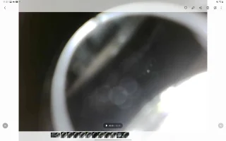

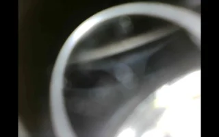

Just picked up a borescope recently and figured I'd take a look at the valves. Unfortunately, the camera can't focus that close and it's super dark, but it's clear enough in person to see a TON of gunk on the intake valves at 20k miles. Looks like it's time for an intake cleaner... or two.
I've attached a few pictures, but they are pretty hard to see. For reference, the bottom right of the pictures are the threads for the spark plug, The light is bouncing off of that which makes is washed out.
If you look closely, you can see the shiny oil buildup at the center. The only way to really tell from a picture is to compare it to what the exhaust valve looks like with the same camera, so I've included that as well for reference.

Thank you for sharing this. I'm assuming your catch can is on the dirty side, between the PCV and manifold? Would you happen to have noticed if the exit hose (between the can and the manifold) was dry or oily?
I've recently cleaned mine at 40k miles. And i will continue to say, the only way to clean them is to remove intake manifold and clean them manually. From past experience, i dont belive that catch cans or any cleaners you spray through intake do anything.

Doesn't look like it is prolonging it for much longer. It does make sense in theory but I haven't seen the proof of it doing much in real life.

Go down the intake. Popping off the upper intake doesn't take all that long.

IMO it doesn't look THAT bad for 20K miles considering you haven't had a catch can for most of that time.
You could do a seafoam treatment ( need to be careful though ) and then it should stay much cleaner with the mishi catch can now fitted.
When I get some time I'll boro my inlet valves and post some pics. I've had a Mishi Catch Can fitted since day one. Should be interesting to see.
