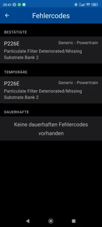

Checked couple of minutes ago wirh my OBD2 and got the same error code with a malfunction on the particle filter/exhaust system.
Better call your local garage to check it. My Mechanic told me I can drive the car to the garage, as long the EML doesnt flash and stays solid. Flashing means a dangerous fault for the motor.

I live in Switzerland (Europe) and have a Model MY21 with the latest software running. Maybe the newest OS is the culprit?

Got my car back yesterday from the dealer. Fault was at the particle filter, it got so full that it couldnt start the regeneration on its own. Somehow the automatic regeneration process wasnt started in due time and the garage needed to do that over the OBD2 Kia Console. Usually the Check Light for the Particle Filter would go on before this would happen so you can drive longer trips with some pulls, but this time it never did. Could be a bug or some unfortunate constellation with some short trips in a row.
