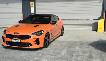

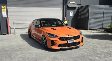

This is a mates car down here... the colour certainly scrubs up nicely :thumbup:
