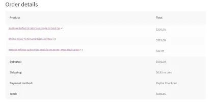

Sorry for the noob questions...but for the catch can, would I be placing an order for the baffled oil catch can or the BMS compact double oil catch can? (Pretty sure it's the regular blue oil catch can shown?) For the Intakes, I think they are great value...other intakes seem to be much more expensive and to be honest, they all should somewhat similar (to me at least out of the ones I watched).
Thank you very much for your help ~
That’s the same catch can I have and it works great and lots of members have that intake and are happy with it. Both solid choices.
