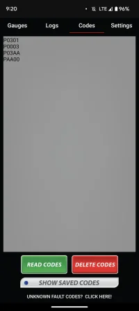

p0301 - Misfire on cylinder 1
P0003 - Misread in the Fuel Volume sensor (could be a short, corrosion, or fuel regulator going bad)
P03AA - Pressure low on Cylinder 3 aka misfire
The last one I have no idea, but based on a misfire code I got on a bad spark plug on Cylinder 2 I got other codes that appeared separate but were actually sensors freaking out because of the misfire
So a little update, I had done a firmware update on the JB4 and the codes have since disappeared along with the car driving well again, I had brought it to the dealer and they said maybe bad gas
