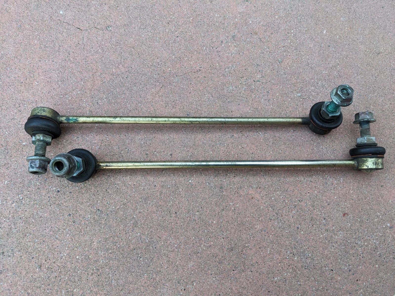

These are Porsche 911 OEM anti-roll bar end links that look just like ours, except even longer. I doubt anybody would argue Porsche specs "weak" end links for their top-of-the-line halo sports car.
We put our Stingers and G70 through their proper paces (track days, autoXs, etc.) and the OEM endlinks work just fine.
Also, the anti-roll bar end link geometry - relative to the attachment points - doesn't change when you lower the ride height. Adjustable links are meant for racing teams that want to corner balance the suspension, such that the anti-roll bars are neutral with race car driver's weight on board. Such endeavors are practically pointless in a street car. Would having adjustables hurt? Of course not... unless installation (e.g., length) is done wrong. Are they necessary? Hardly.

Every "issue" I've read about is always someone claiming the OEM end links are weak or otherwise prone to failure as a justification for buying aftermarket endlinks, but I've yet to come across any substantiated evidence of such failures. I do remember seeing somebody's post of a grainy picture of a bent end link, which I seriously doubt could've resulted from just driving the car... even in HPDE type settings.
Any anti-roll bar end link see either a tensile or compressive load. A steel bar has enormous tensile strength, so there is simply no way any suspension load could possibly be strong enough to come within 2-3 orders of magnitude of that steel bar's tensile strength.
So that leaves compressive load. Now, one could argue a compressive load on a long slender bar could result in a buckling mode of failure. Even if that were true, which is highly doubtful, any suspension compressive load is almost always a temporary one (e.g. when cornering at the limits, or when impacting a bump over the road surface). In that scenario, at most the end link would experience is a slight momentary buckling. Because such deformation is elastic, there is no way the end link would sustain a permanent plastic deformation. Those pics of "bent" end links were either from a car that sustained major crash damage... OR somebody falsifying evidence of the supposed "weak" OEM end link... with a big ol' sledge hammer.
Any self-respecting suspension engineer would have done their due diligence by applying Euler's buckling load equation to make sure their end links will not experience buckling. My money is on the competence of the Kia/Genesis engineer that worked on the Stinger/G70 - knowing how to balance strength and weight, such that the OEM end link is just strong enough, but with sufficient safety factor to preclude possible failure in worse case usage.
