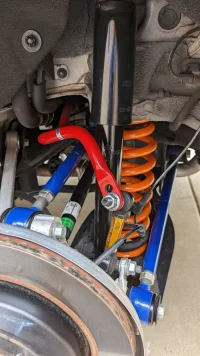

If they did it for half of that would still be ripping you off. Old pic many mods since then. whatever you do, don't buy white line end links unless you like noise rattle and retightening both all the time. Use Godspeed.PXL_20230529_000031306.webp
