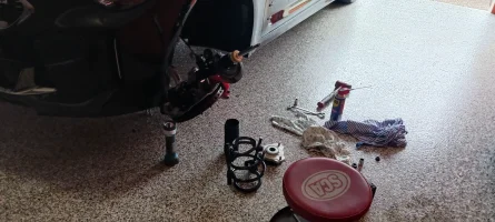

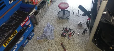

So I was a tad lazy last night while I was swapping out springs as it happens. But when it came time to pull them apart I notice kia has the not so normal to myself strut tool of key way what ever word you'd like to use. Figured I'd toss this out if it'll help anyone. Again. It was late and yea haha. But if it works it ain't stupid right??? So I had some spare .030" flux wire laying around from spare spools or whatever. I happened to notice a 8mm Allen fits damn close. But a tad loose. So I ended up just sliding some peaces of the flux in the open slots and taped it to the allen. I first started with a peace on all six sides of the 8mm Allen but noticed it woulda been kinda a pain so pulled one back and we'll yea it worked great. Hopefully someone needs it or just be smart and not half asleep like me ha. See pics. Again I'm sure there's a better way (like the tool) but being almost 3am and yea.

Yea. I guess I could of went to the parts store at 3am to get the correct tool. Not sure why I didn't think of that haha j/k. Yea didn't have the tool so I improvised. I had it set up in a press for r&r of the springs. I don't like to leave it in the car as it's a tad hard to see the shock shaft to verify it's not spinning and going to burn up the seal. But yea I just zipped it off on the floor. Surprisingly it didn't have as much stored energy as I thought it would do to previous change outs. But either way they got swapped out and now I no longer look like a pre-runner ha.
