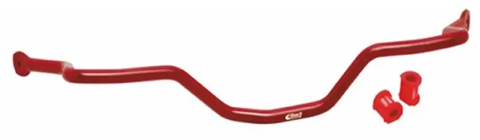

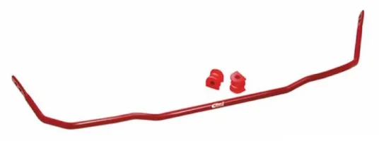

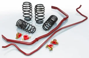

@Paul @ K8 Stinger Store , the pictures on your site for the PRO-PLUS kit (springs and bars), the individual roll bars, and the front/rear combined roll bar kit all show different bars, with different mounting holes, bar shape, and mount fittings.
Is this because they are generic pictures - or are the sway bars in fact different depending on which option you go with? The specifications all state 19mm front, 25mm rear.
Those are all generic pictures. The stinger parts are different than any of those pictures
