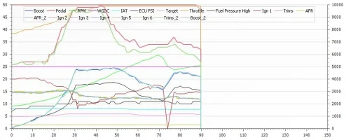

I opened the "map 3 with problems" log but I'm hard pressed to see any problems. What do you think is wrong with this exactly?
You dont see any problems with ECU_PSI on 19?! Especially with Boost2 on nearly 25psi?
imho that's way to high, because if i drive on map0, it also goes up to 19psi, both ecu_psi and boost2.
I mean i can also feel it with extremely unsteady ignition while being on half gas, f.e. driving in the traffic and just casually flowing on the street. The acceleration feels extremely unsteady, car drives really bad. Restart of the car sometimes help for a short time, sometimes it just needs 1-2 boost-ups and it's back again.
Is your concern that your boost is just higher than normal? If so lead with that because the issue has nothing to do with ECU_PSI. Boost is likely from your modified exhaust combined with cooler weather.
Use JB4 EWG connectors to slow down the turbines if you're looking to run less boost. Start with FF = 35.
Also I only check this forum once every couple of weeks so email us if you need quicker support on it.
