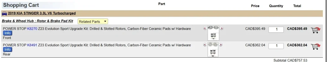

So, Brakes are finally fixed, and this time it looks like its truly resolved. Short story is brand new OEM rotors all around and PowerStop Z23 pads. I personally scrubbed the hubs and removed all rust and torqued all related bolts to proper spec. Cleaned caliper areas were pads sit and lubed back of pads only. Zero vibration, a plus is braking feels similar to stock without the sponge feel. This is good because the yellow stuff pads had a more aggressive compound as a result it seemed to interfere with emergency braking. Had alot of unintended abrupt stops. Very little dust. And no visible pad prints on the disc which yellow stuff did a lot. All parts from Rock Auto came up to about $600.

As far as the items, these were the items I have:
1 x Z232144
2 x 09D02811 (OEM rotors)
2 x 09D02711 (OEM rotors)
1 x Z236012
I am 100 percent satisfied. no vibration, just normal braking. I don't have to do all the babying, such as making sure to keep the brakes released when hot to avoid pad imprinting etc. in fact, I use the auto-hold feature often and don't even worry about the pads leaving residue. A few times I really had to stomp on them and they didn't disappoint. I highly recommend. Very low dust as well
Thanks for the part numbers - what a great price ... $580.72 CDN delivered! Looks like I am going to follow your lead.

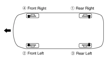

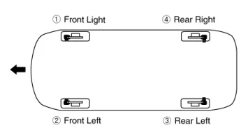

If you have Brembos, there are two things to be aware of: you'll have 8 bleeder valves (recommendation is to do inside first, then outside), and the bleed order is different (start at front right and go counter clockwise, vs. the usual method of going from furthest away to closest).
I asked ChatGPT about the ordering, and it said with a modern hydraulic control unit, it might be to purge priority circuits first (fronts), or it might be that with the HCU's internal valving, this order ensures you purge "upstream" circuits before moving downstream, and avoid pushing air from one to the other.

Brembo:
Non-Brembo:
We've bled ours either way. No difference really. Just make sure to top off the master cylinder frequently and you won't suck air down, regardless of how you bleed yours.
Just the fact that you're flushing your old wet fluid out is already way better than those that dont bother or dont believe in the importance of having fresh dry brake fluid.
Thank-you gents.
Yeh nah I will continue bleeding mine the way I do all mine and my customers cars thanks.
Furtherest away from the master cylinder first always...
