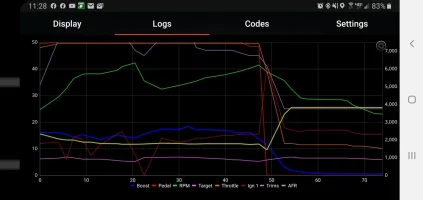

I wish I was better at understanding the chart/logs that the JB4 gives me.
This is the image log is also attached.
This is 5gal of E85 mixed in with a FULL tank of 93
JB4, Injen Intakes, ARK Downpipe are the only performance mods.
ING1 if I understand correctly the first 2 drops before the first shift indicated by the Green line seems that maybe not enough octane, but like I said I'm newish to trying to understand the chart and logs.
You could try to speculate but would be pointless IMHO, a dragy is the best way to measure "real world" performance.
Why are the trims so high?
E30 and no fuel wires maybe?
