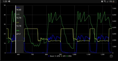

so your argument is I've had lots of dyno pulls and my car hasnt blown up so its good???? Really Dude come on. I go in every tuning thread and lookat the details and provide feedback. I'm sorry that TORKS the fastest and you have beef with Tork... But if you note I +1d Kagan and Dynocomp...

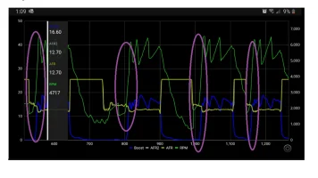

If your tune is done why not post FINAL Stage 2 graphs that don't show a huge dip?
Same reason i didnt share a full log. Its not my business. You act like I own Alphaspeed. Yet I dont go into Kagan or Dynacomp thread saying Alpha is better. Stop being so ignorant.
With 18 where is a example of a good stage 2 graph or a draggy time showing lc figured out? Kagan gas shared some draggy times that atlesst indicate he's making progress. All we have for as is the graph which shows peak hp but issues during boost onset.

According to you. Why dont you dm them they wont give you anything since they know very well what your motives are, but you can try.
As you see there are 1000s of tuned with piggy or ecu stingers how many of them post their draggy or slips on here or facebook? 30-40...

I reached out via Facebook. Tbh the curve looks good.
