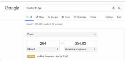

Anyone know what those numbers equate to in HP and TQ?
That was my similar situation. AWD, JB4 Map 2, DIY intakes, rear cat delete, Borla cat-back, 93 octane......370whp 510wtq
For future reference, just ask Google for any conversions, via voice query or typing, what you want done (dimensions, weight, volume, currency, etc.) - it's got every conceivable conversion you might want, and the results are immediate! :thumbup:
