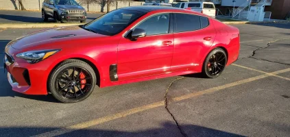

It also depends on what you need the wheels for. For example, I bought some cheaper wheels, they're Konig Oversteers. I like the look of them and I just got them to throw a set of wet traction tires on for the winter. It was difficult to find the stagger and everything, and I didn't want to have the tires pulled off the rim every time it changed seasons, nor could I stomach putting some ugly steels on so this was a good alternative. It does the job for what I need.

They're 8.5's all the way around. I honestly haven't noticed any more spray on the sides of the car than with the stock wheels.
Probably means your offset is just fine, the stock wheels are pretty recessed.
