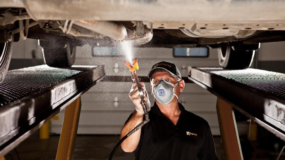

When I lived in PA, I had all of my winter vehicles Krown coated. If you plan on keeping the car for any length of time, I would absolutely do the same thing every year. The downside, it is messy and gross. The upside is that it just won't rust. Cars today still aren't rustproof, and there's a lot of steel in the Stinger.
Being in Canada, the only rustproofing I can wholeheartedly recommend is Krown.
Krown, or "Corrosion Free" would be my top choices Corrosion Free is a lot less messy, but harder to find

Most of the oil based sprays require a yearly application and are around $100-$125 for an application. The dealers usually offer another product that is supposed to be a single application, it's like a waxy yellow substance but they mark it up quite a bit and usually try charging $500 or something like that when you're buying the car.
I think if you live in an environment that uses road salt or near the ocean it's probably worth doing if you plan to keep the car for a long period of time. If you plan to keep the car for 5 years or less it's probably not worth it. The effectiveness is highly debated.
Corrosion free is a 18 month cycle, so every year and half
@Luc343 - you should see the amount of salt we put on the roads here in the winter... plus the rust protection isn't so much about the body, but everything under the car... unless you like to pass the salt truck as it throws rock salt all over the side of your car
