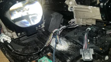

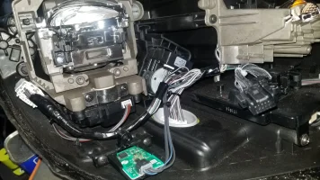

If it's a USDM GT2, you definitely want the 22. The housings are identical, the only external means of determining which is which is that sticker. The internals are interchangeable, but nothing is accessible without removing the lens. That, and calibrating/ adjusting the motor and armature for the dynamic bending light isn't a task I'd like to tackle. I'll go through my pictures when I'm off work, see if I have anything that may be helpful to you.20201130_165532.jpg
This is the internal view of the 12
This is the 22 (with the projector lenses removed)
After looking again, the housings are the same molding, with identical part numbers. I don't know if that helps, but it is what I've got currently. Let me know if I can help further.
