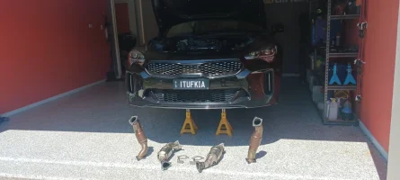

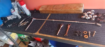

I went catless for my primaries and I didn't have to drop my engine lol. The studs tho can definitely be a PITA tho
