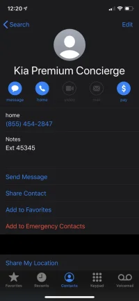

87D0A068-7044-460B-B458-CDFCCA060DEB.webp Call the premium hotline. Explain that this is unacceptable. Explain that others have had their entire roof/rail assembly replaced and it solved the problem. Also explain that a loaner is mandatory.
squeaky wheel gets the lube homie.
View attachment 37678 Call the premium hotline. Explain that this is unacceptable. Explain that others have had their entire roof/rail assembly replaced and it solved the problem. Also explain that a loaner is mandatory.
Thanks! I'll go down this path this weekend, after getting a good recording of the roof noise and radio issue so I have permanent evidence to provide.
