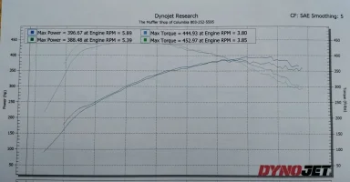

I've been researching RaceChip because I'd like something that's easy to remove when having service work done, and I couldn't help but notice every time someone posts about RC, at least 2 or 3 JB4 fanboys will jump on the thread and crap all over it. This is the first time I've come across a direct performance comparison between RC and JB4, and it pretty much confirms the RC reviews out there for our platform (I say "our" but technically I own a G70.) Just surprised after seeing clear documentation that RC gives you the same performance for way less money as JB4 on 93, that no one jumped in to crap on your post.
Although I am currently leaning toward an ECU tune as it seems as easy to swap an ECU as it is take out the RC, I want to thank you for providing data I haven't come across before. Certainly removes doubts about missing performance if all I plan to do is gap spark plugs and run on 93 octane.

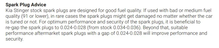

Good question. Racechip often states how good their hardware is. I sent my Dyno results to Racechip back in 2022. Of course they aren't going to share any trade secrets but I attached their response.
