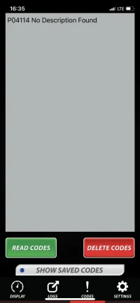

Anyone know what this code is? I’m not finding anything.
Read with a generic OBDII reader, wonder if we're converting it wrong.
If you drop off the last digit it pulls up a bunch of info on google. (Exhaust cap loose, 02 sensor) all kinds of stuff. This car has been all sorts of problems for me and we haven’t even done any intrusive mods yet!
@Terry@BMS that should give you something to go off of. This car is getting very frustrating. Wtf man why is my car having all these problems and everyone else for the most part is not..
Maybe it isn't the car but the JB4? If you think it's the car take it to the dealer so they can fix it.
Read the code with a generic OBDII reader so we can confirm what the code actually is. Most likely it's P4114 and the app is adding an extra 0 after the P. I saw on another platform it's the EVAP system though, which would be the gas cap, fuel tank lines, things along those nature. You need to confirm that the code is 100% though as your next diagnostic step.
