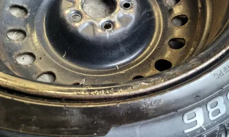

Last night - hit a pothole on my way home - unavoidable I suppose. It was camouflaged by a shallow puddle of recently melted snow :(
Drive home - Minor vibrations as if I lost a wheel weight. - no loss of pressure. for the remaining ~30 minutes drive. Park car and forget all about it.
Next day - today - drive to work - about 0.8 kms into my drive - car beeps and tells me - low pressure in one tire (24 psi)
As I am turning around to go back home - 20psi
then 18psi
then 12psi
then 4psi
Made it back to my driveway

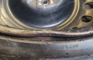

Inspect - arrgghhhh
Pull the wheel off and inspect the inside of the rim - arrgghhhhh
Start with a 5lb sledge and a very beefy drift
Something like this (not my image)
Soon after - escalate to a 10lb sledge
40 to 60 not so delicate, but reasonably accurate, impacts later - I have some something that resembles round again :)
Inside lip
Outside
Lets try this again - cold pressures
As tire warms up - 8 kms into my drive - pressure holding
After my 70 km drive to work - Pressure = good
Comparisons
I do believe these cheap steel rims are not as strong as alloy - but certainly more easily repairable.
Would an alloy wheel have been damaged over the same pothole - I will never know.
I'll paint them later!
My local tire guy schooled me in why winter steel rims are inferior to most alloy wheels in terms of strength. Most people think steel wheels are superior but in reality they are not. Until my wheel guy showed me a demonstration, I did not believe it for years prior.
I'm not arguing steel are superior in strength - however maybe superior in "at home reparability"
I am not a steel wheel saleman.
I cracked 2 alloy non-OEM wheels on my old Mazda 3 in winter driving - and I was unable to repair either of them.
