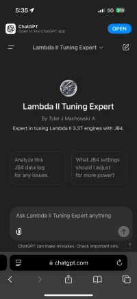

For haha’s I made a gpt
Gonna try flooding it with data as “training”. Eventually, I hope it can learn my car and notice trends I may not see when just plotting a single run.
Link below brings you to the GPT. It’s still preliminary so I didn’t make it public yet. Respond to this thread if it does anything cool.
ChatGPT - Lambda II Tuning Expert

Gonna try and do a variety of both. Stupidly, I deleted all my logs, and I’ll definitely have to do some crowd sourcing. For consistency, I’m only going to feed in the “standard” 3rd gear pull logs for now. With the driving conditions consistent it should have an easier time interpreting the data.
I do think you could directly feed it things like the BMS explanations of each parameter, and each map, and the writeups from Terry.
Wow, we’re really operating on the same wavelength. I copped a couple of Terry’s reference guide posts into text files, then uploaded them on the GPT’s backend knowledge section. Here are the topics I have so far, let me know if you can think of others;
- JB4 logging parameter descriptions
- JB4 map descriptions
- JB4 user settings
- How fuel trims work
- A sample log to show formatting
So far it helped because some of the parameter names have seemingly random names. Some topics still in WIP;
- What is the 3rd gear pull and why it’s the standard
- Instructions on what data matters (WOT, 3rd gear)
- Some binary good/bad criteria (jagged ign1 curve)
Please reply with any “training” topics you think I should include!
