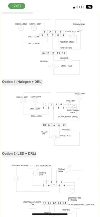

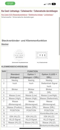

Hello, has anyone changed from xenon headlights to full led lights? I have one broken lamp and I want to put on better full led lights :) Does anyone of you guys know how to do this? What is needed or do I need to change something in the installation? Where can I buy an adapter to change these headlights? Any help is welcome, thank you Photo for reference

Thank you, is there any diagram or video how to do it better?
Not that I know of.
