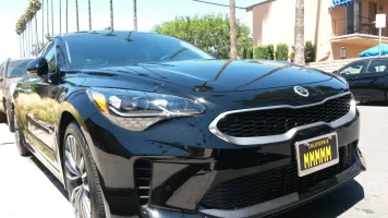

I went ahead and got a guy to apply CQuartz for me. Was only a 3-hour job, if that, about what a normal detail would take, except I now have ceramic coating! I absolutely love the shine of the black. It's like a mirror. And when I park next to other cars mine really stands out.
As others have advised, I will be using Reload on this every couple of months to maintain that gloss.Stinger-CQuartz.webp
