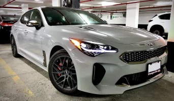

Just curious how they look? I'm considering them for my ghost grey, but leaning towards matte black ... I like the slight asymmetrical look of them!
They look pretty good to me. It was pretty inexpensive so that’s also a plus. I didn’t go with black because it gets/appears dirtier more quickly.
if you’re interested in these and are in southern Ontario, I might sell them for a good price.
Yes, they look great - thanks for posting the pics! I'm in SW Ontario, and appreciate the offer, but I'm looking for 19s. Thanks anyway :)
