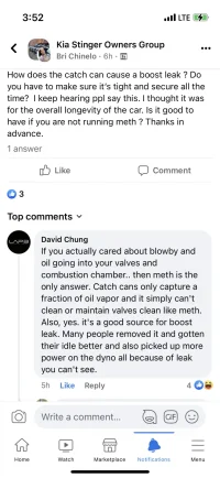

How does the catch can cause a boost leak ? Do you have to make sure it’s tight and secure all the time? I keep hearing ppl say this. I thought it was for the overall longevity of the car. Is it good to have if you are not running meth ? Thanks in advance.

Alot of local ppl around me in the dmv area just had a Dyno day and everyone one of them, besides the ppl who were running meth , removed the catch can because they said it could cause a boost leak. Not sure how this is but just wanted to know some more insight into this. My catch can was installed at my local shop as well so I know it is good but still curious about this . Hope someone can clarify or chime in.

Gotcha thanks. I’ll check back with the local guys and girls to gain some clarity on this as I would hate for this to happen to any of us with catch cans since a lot of ppl have them. Rather be safe than sorry.
posted in the fb stinger group and this was David Chungs reply (lap3 owner)
Um, OK....
But if you have a good catch can, plumbing and a good PVC Valve all correctly installed, where does the boost go?
As for water / meth, well that's another topic all together.
If you have air leaking through the catch can...... PCV.. and if you remove the catch can - you still have the same leak, just no catch can to leak through.
I don't get it
