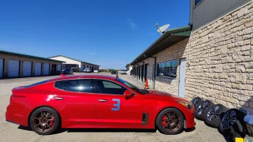

We have two sets of Enkei TFR 18x8.5 ET38. One set with 255/40R18 Dunlop A/S is currently on our G70 for everyday driving. IMO, that is a better setup for 3.3T to handle the torque it can put down, and that's why the OEM rears are 255. However, my oldest drives that car and he prefers the fatter tire look. It's about 1 lb heavier than I'd prefer, but going with 18s (smallest that would fit over the Brembos) means the tires have moderate profile and excellent compliance. Lighter weight wheels mean less unsprung mass for better suspension control, and it also reduces rotational inertia for faster accel/decel.
On my 2.0T Stinger for everyday driving, I actually run on 235/45R18 A/S tires on my old Genesis sedan 18x7.5 rims, which weigh a surprisingly light 23 lbs each. For regular commuting, I have no need for street heroics and so much prefer to tilt towards comfort and "real-world" traction. Handles plenty good enough for the occasion cornering fun, but boy... do they ride supremely smooth. The car maintains composure even over rough pavement. I did also swap in an LSD from a 6MT G70, so that helps too.
The other TFR set is our dedicated track set currently with 245/40R18 Kumho V730, which is about 1/2 way through its service life and will likely be replace with 245/35 or 255/35R18 when the time comes. Rolling diameter will be a bit smaller compared to stock, but on the track, speedo accuracy is a don't-care, but we would appreciate the faster spool up and less rotational inertia. As I mentioned above, at the track is where the low profile tire's sharper turn-in really shines. We run them with 5mm hub-centric spacers up front to correct scrub radius to within 1mm of stock 34mm. Rears go on as is.
