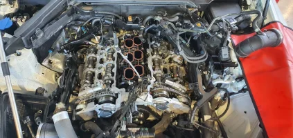

I bought a water damaged car. I cant register it here so it was always going to be a test bed to see what I could get power wise and play around. I however missed the notes that it was so heavy and I can see a lot of weight is probably in the roof ha ha. Ok so my damage ... We pulled out countless litres of water IN the engine. Water in exhaust, intercooler, bores. The engine couldn't turn because it was hydto locked. I lubricated bores and valves as much as possible. Some valves were stuck we took our time and unstuck them. Completely drained the fluids and replaced (though nothing was contaminated).
Changed plugs (Not sure if already public knowledge but i can share a coresponding Denso plug number that is cooler and works - just needs gapping).
I believe these to be the hks plugs ;)
Interior wise its dry but moldy (needs a strip clean etc) most of the car works. But the seats can't move (physically stuck and electrics toast so not yet sure what I'm doing there.
Otherwise the car now drives, got taken for an alignment and looses traction when you want it to ha ha

wow, good luck with the water damage. was it saltwater? saltwater is a nightmare, the worst kind of water damage. Compression test the engine, especially with hydrolock damage. The biggest things on mine were the right turbo swap and the power steering rack. all that is left is paint and front end assembly. IMG_4672 (1).webpResized_20200127_161939.webp
