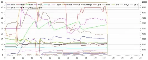

How's it going everyone? So I have a 2022 Kia Stinger GT1 AWD.
Mods: Injen Intakes, Borla Catback Exhaust, Velossa Tech Air Scoops, HKS Spark Plugs gapped to .022.
Conditions: Weather = Cold as S*** lol. Was going up a decently large hill to get into the highway.
Map 2 with 93 octane.
Launch control and went to about 104 mph.
Thank you in advance!.
I wouldn’t say great but not bad and you are probably ok. But you are getting some timing pulled in a few cylinders. Your number goes to 4.5 which is a bit on the high side but only shows up briefly and your trims are a bit off in the same area. Hopefully someone with a higher pay grade than me will show up with a little advice. Cheers
Not full throttle the entire run but seems fine to me for 93.
Hey Terry thanks! So do you have any advice? Everything looks good for the most part?
Yeah I went full throttle from 0-70ish and let up slightly from 70-104.
