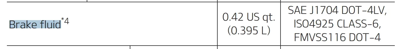

+1 o the motive.. Good stuff. How much brake fluid does it take for a full flush on this car? One 32oz enough?
Fancy. In past cars, I've found the dot4 fluid to discolor more quickly than dot3.
I don't have the fancy brakes either, will prob use dot3 when i do the flush next summer (2yrs). Manual says to change every 4 years. Seems lengthy to me.
Based on this a 32oz should be enough. But agreed, unless it's discolored significantly, hard to tell when the new stuff is coming out. Looks like they recommend dot4 too. Don't need the LV stuff here, maybe in canada.
