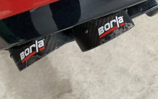

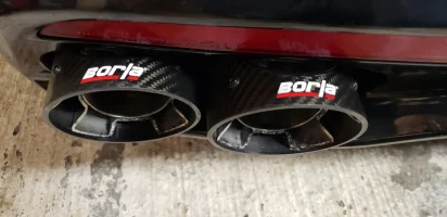

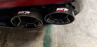

I have these Borla tips as well, and am extremely disappointed that after just under 2 years (30K miles of driving), the finish at the edges is pitting. I live in Canada so we have all 4 seasons and use road salt in the winter.
Given the exorbitant, highway robbery pricing, I expected the finish to be better quality. I emailed Borla some feedback, but no response nor a thanks for the report, which tells me they don’t care, so I would not recommend these to people who DD their cars. Buy them if you like them and your car is a museum piece or a summer car.

Up in Canada here too. Ottawa area but I got the car from Belleville. Driven year round since 2020. One and a half winters, car has 58k and I am putting on 5k every 6 weeks or so to sunny Mississauga by the business park? 99% highway. Before I owned it was a garage queen with little or no winters. Road warrior now. Tips are ok but I am going to keep and eye on them now and will talk to a family member in the composite industry re why yours are pitting/peeling. Carbon Fibre is impervious to most hostile environments. From your pics it looks undamaged. The resin Borla used seems to be ok as well, no obvious delamination, it is under zero load so I would not expect any. The clear coat however is my bet on the weak link. Poor bond to the carbon fibre tip, bond failure and then weeping in the open exposed end and chipping of the clear coat. In epoxy, this is a symptom of improper cleaning of amine blush from the epoxy after it cures and then finish to component bond failure. Not sure if Borla uses epoxy or vinyl-ester or ? resins to make the tips and getting crickets from them is most helpful. To me this looks like a manufacturers defect. If we knew what product was used originally to coat them we may be able to properly clean, surface prep and repair the finish. If mine go this way I will be pulling the four screws out to hopefully remove the carbon fibre ring, soak clean in various liquids and then using the underside to test what repairs look like. I am thinking a very low viscosity outdoor UV stable marine type finish so it wicks in and has a reasonable chance of lasting. As to Borlas' million mile warranty. Check the weasel out from their site:
