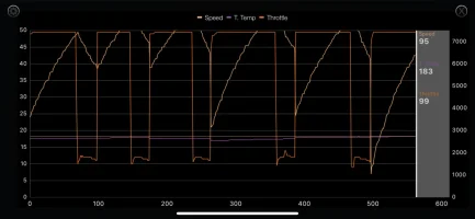

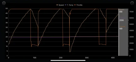

Some before and after logs with Burger Motorsports Trans Cooler. Before the cooler, I would hit 200 degrees pretty quickly after a few back to back pulls or driving long distances. After the install, the highest I have seen is 183 degrees after 8-9 back to back pulls. Both before and after pulls were with launching the vehicle and ripping through the gears up to 5th.
Great product and cheap insurance if you ask me.
