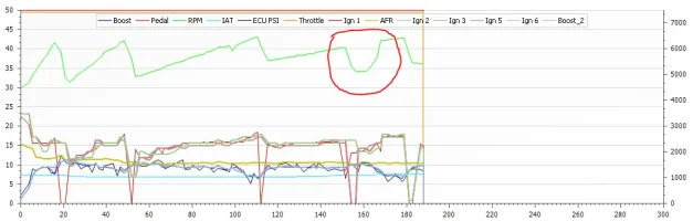

I have tried some pulls on Map 0 with no other mod (=> completely stock) and I have seen the problem occurring identically.
Fortunately, I still have the log of when it happened. See for yourself.
