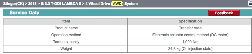

That is the rated load, and those numbers are official. 1,100NM is 811TQ. Those are ratings for the transmission. I am still searching for the transfer case on the AWD vehicles.
That makes sense and good to know the 800TQ limit mentioned previously is official. If you don’t mind sharing where you confirmed those numbers I would greatly appreciate it. Many people have questioned the transmission limits before and would be nice to have that resource available.:thumbup:
Sure thing. I did make a typo though. 1,000NM TQ. Direct from KIA. This is the only TQ capacity data I can find for the transmission components.

800 WTQ limit? Horry shet. Well that won't be going anytime soon assuming cooling it doesnt become an issue. Anyone have any numbers on the rest of the driveline? I'm starting to gain more confidence in everything behind the transmission as people rag on their modded and tuned stingers and launch them repeatedly with no issues so far but knowing what Kia thinks the setup is good for would still be nice.
The transmission is the last in line to fail, there are other components designed to break prior to the transmission. I haven't found any data on the true WTQ rating on the driveline. I'd imagine there is a small safety factory in this setup, so let's say 700 WTQ before you start twisting drive shafts and stripping out front axle flanges.
