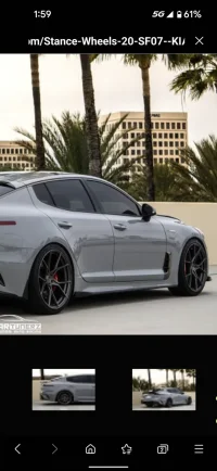

I don’t know if this pic helps to get an idea.
Good looking car would look even better lowered tucked I say go for it pic of a stinger with 20s on springs

OP, you car does look nice. I almost think there's a bit of poke though. If your tires are already sticking out past the top of the fender you may run into problems with a drop. If the fender is still covering the top of the tire (when looking down from the top) then the drop should be fine, especially because you'll be adding a little negative camber. I would ask the seller for the offset though, then someone on this forum can confirm you'll be good.

When you lower your car there is a degree of camber that is applied which basically angles the top your wheels more inward. This will minimize the poke and tuck the wheel more under the fender. BUT if the offset of your wheels is high ie. +25 etc. you will probably rub even with the natural camber applied from lowering springs. The picture I posted is a +35 offset for the front wheels and +40 for the rear.
Looks like it may cause a problem. You need to get the offset figures to be sure.
