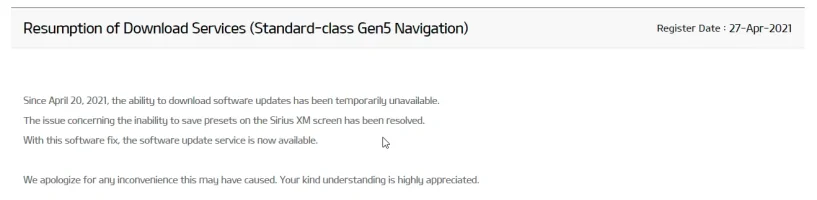

Ah! Thanks for catching that. Don't use XM, but it sounds like they're at least responsive to issues. Maybe time to upgrade now!
