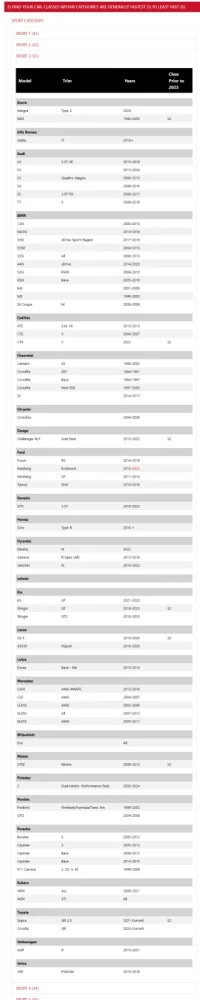

According to this link:
The Stinger falls into the Sport 3 (S3) class for anyone wondering. The link in the OP isn't working for me either.
Here is a screen shot of the full list from the site:

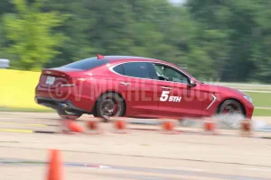

My GT-Line falls in STH because of the catch all rule:
Sedans & Coupes NOC (nonsports-car-based; 4-seat minimum; less than 2.5L (2500cc) forced-induction)
The local SSCA chief questioned me if I should be in STU. I pointed to the above catch-all and the fact that my engine displaces exact 2497cc. :)

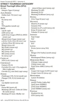

3.3T Stinger is specifically called out under STU. Even if it isn't, the catch-all rule for STU is fairly clear:
Sedans & Coupes NOC (nonsports-car-based; 4-seat min.; over 5.1L normally aspirated or 2.5L to 3.1L forced induction)
Realistically though, Stingers are not competitive in either case, as I mentioned above. We got into AutoX a couple of years ago, because I'd wanted to introduce my oldest to HPDE. We started out running in Street class - as anyone starting out should - to establish a performance baseline for this chassis. Then we started doing suspension mods to tune the car for track duty, first lowering springs, then later coilovers. Our focus was not on being competitive, although we do try our best every step of the way. I wanted to show my son the effects of suspension tuning and how each mod impacts track handling and overall performance. For us, G70/stinger have been great teaching tool.
For your 3.3T, if you're lucky, your local chapter is small and doesn't have a whole gaggle of SS 1LE's running in FS. Otherwise... forgettaboutit! Those are factory V8 track machines that weigh the same as the 2.0T Stinger.
You could move up to STU and start modding up, but then you'd be fighting against Civic Type R, STI, and Golf R, which are 500 lbs lighter, short wheelbase, and have aftermarket support the likes of which we Stinger owners won't see in our wettest dreams. Even Hyundai's own N cars (Elantra and Veloster) will eat you for lunch.
Not trying to discourage you, but do try to keep it all in perspective. I constantly remind my oldest that this whole affair should be about the DRIVER, not the CAR.
Do you mean "called out" as allowed, or excluded? Because if it's the former, I'm missing something...
I meant: it was specifically named on the list of cars under STU.
I think the confusion might be caused by the "catch-all" clauses for STU/STX being somewhat unlcear. STU calls for over 5.1L normally aspirated or 2.5L to 3.1L forced induction), but some cars on the list are larger than 3.1L turbos.
STX is actually the next level down (3.1L to 5.1L normally aspirated), although it doesn't mention the displacement range for forced induction.
You can read the latest rulebook here: https://cdn.connectsites.net/user_files/scca/downloads/000/072/794/2024 Solo Rulebook August adjusted.pdf
That's what was throwing me...I guess they have to set the line somewhere, but then end up with cars just over or under a cutoff that really don't belong there, and move them accordingly.
