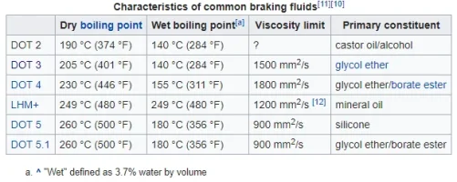

I agree on the need for clean/fresh brake fluid, but I do wonder how they'll check/enforce that. High temp brake fluid is a good idea anyway - DOT4 or DOT5.1 (don't bother with DOT3 as the boiling point is too low for track work, and DOT5 is chemically entirely different being made of silicon instead of glycol ether, you can't mix it with DOT 3/4/5.1 fluid, and to use it requires different seals and parts in your braking system, avoid that too unless you know exactly what you're doing)
You'll note that the wet boiling points are WAY lower. DOT 3/4/5.1 brake fluid is hydroscopic - it absorbs water from the atmosphere. As you can see, it doesn't take much water in the fluid to significantly reduce the boiling point - and boiling brake fluid is BAD when you need to stop, as it creates bubbles of gas, and gas compresses much easier than liquid - meaning your brake pressure goes into compressing the gas, and not into pushing your pads into your rotors - if you suddenly get a pedal that goes to the floor when on the track, you've either blown a line (bad, no more track day for you, and it may close the track) or boiled your fluid (not quite as bad, but ultimately this ends your track day just as much as a blown line does).

Of course, better fluids have higher boiling points - these are the MINIMUM specs..
