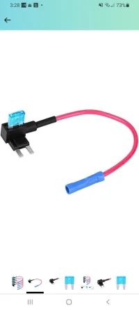

Open the small fuse box down there in the same area. Look for a piggyback fuse he/she used to wire it in, probably look like this:
If you pull the piggyback fuse and just put the correct sized fuse back in place without the piggyback you should return to normal, than you just need to follow that wiring to the stupid light and remove it all.
Tip: the inside of the fuse door youll need to open will have a fuse diagram indicating the correct fuse size for factory so you know which size to put in where the piggy back was.

Looks like the piggyback fuse was plugged in right below the stock fuse, all I did was disconnect it and hid the wire in the fuse box area, covered it back up, and it's as good as new the stock white light appears to be on but fairly dim (assuming that's normal). Going to go on a drive once the sun goes down to see how it looks. Now I just wish the stock ambient lighting was a little brighter.
