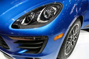

the side amber accents that are white on other models in other countries. they can be white on our stingers legally as long as we have an amber reflector somewhere near the front bumper or headlight. porsche, and beamers have all white headlights with tiny little amber accents separate from the car
see the pic for reference View attachment 4703
now the actual turn signal lights I'm not talking about
this
instead of this
