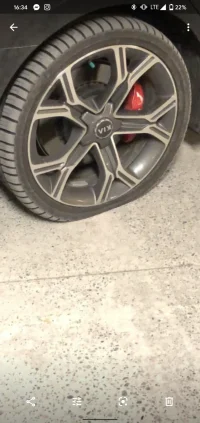

Just hit a construction-related pothole today.
The TPMS instantly showed 0 psi on the rear-right tire, but I was still able to drive (albeit carefully) a bit less than a quarter mile home to park.
What are the chances that the actual wheel was damaged as well? Don't want to spend more money on a new set of wheels...
Just thought I'd ask before I change to my spare and visit a tire center in a couple hours...

Take it to a trusted tire specialist. They can dismount the old tire and spin the rim up on the balancing machine. There, it will be easy to spot any out of round of the rim or cracks to the lip and barrel. Once the new tire is installed, they can soap up the rim and look for slow leaks as well.
There is no way to know without inspecting the wheel as pointed out above.
The chances are 50%. It's damaged, or it isn't.
Thanks all.
Took it to a tire rack authorized installer, they seem pretty trustworthy per Yelp.
Luckily they said the rim wasn't cracked. My assumption is because it was a bit over inflated at 45 to 47 psi.

Also definitely will be submitting a claim to the city.
