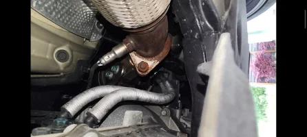

Went to install a midpipe on my 2018 Kia stinger gt-line 2L and annoyingly, there seems to be another sensor on the midpipe itself! I can't see any other cases of this and wondered if any of you had come across this. Is this another 02 sensor?
Instructions claim it should have been a straight pipe swap but apparently not... Might not even have room to drill in for a bung due to the flex pipe.
Korean import to New Zealand for what it's worth.
I was unable to post pictures due to the websites ablocking... Please see attached picture and there's a video link below.1000008828.webp

Forum wouldn't let me post pictures due to adblockers, here's a pic - any thoughts?

It most certainly is another 02 sensor... bugger.

Thought so but wanted to check, appreciate the response. Unfortunately the mid pipe I brought has a flex pipe too close so I can't drill and weld a bung in to fit for the 02 to thread in - have contacted the company and they've said they haven't encountered this before and are organising a return. Guess this is a quirk of NZ/AU!
Hopefully this thread helps someone going forward - check before ordering haha... I had assumed it would be fine.
