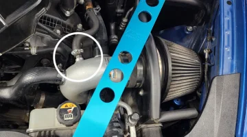

So this started happening to me after the turbo coolant line recall work was performed. CELs, stumbling at idle. Dang car sounded like it had a lopey cam. Wasn't boosting well, etc. etc.
Since it happened pretty quick after the recall work, there was no diagnostic or repair fee. I am not sure I could equate diagnostic fees at my dealer to yours, but if it hadn't been covered, I am pretty sure they would want an hour labor.
In the end, I was pretty lucky because it was a loose fitting on my K&N intakes. The tech fixed the loose fitting for free. :cool:

Here's a picture of the loose line on my intake (left side of car)
Pcv... some aftermarket kits like K&N include 2 sizes of that barbed plastic, my AEM kit only had 1 and that was too narrow so I had to improvise to stop the vacuum leak .
