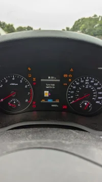

Here's a shot of what the dash looks like. It definitely seems to be a computer communication issue and when it happens it disables many features.

if they went to the trouble of making a little diagram for that fuse switch on the cluster, I'd take a peek at the fuse panel, and dig out the manual....
What are you suggesting? I tried resetting that switch. It was on, but I flipped off and on in case it was a faulty trip, but I believe that comes up simply because it's one of the many elements after the wiring fault. It runs through the whole list and ends on that one. I'll ultimately take it to the dealer , but my local dealer is terrible. I was hoping someone may have encountered this and knows what it might be.
