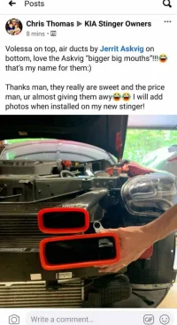

Been doing some homework on my options. I don't want/need a CAI/ram intake, perfectly fine with the stock box based on other reported findings with a high flow filter (probably K&N). I'm wondering about the snorkel options available, as the tests have indicated restriction is greatest at the point where the air crosses the radiator grate. I saw a post where someone makes them for $125 (a pair?) using a 3d printer, but that require some retrofitting. Is there a cleaner install option?
Fwiw, I've never removed a front bumper but assume being handy it won't be too big a deal based on these instructions. If anyone disagrees, definitely tell me. lol
The bumper is pretty easy to remove. As far as retrofitting, you'll have to do that whether you use the AirScoops or the other brand.
There's some liberties of depth being taken here, but I get the point.
[the lower snorkel is being held closer to the camera, exaggerating the size difference]
These are the ones I linked a few posts back, $150 /pair from the store.
Yeah I didn't take the pic and have never compared them in person.
